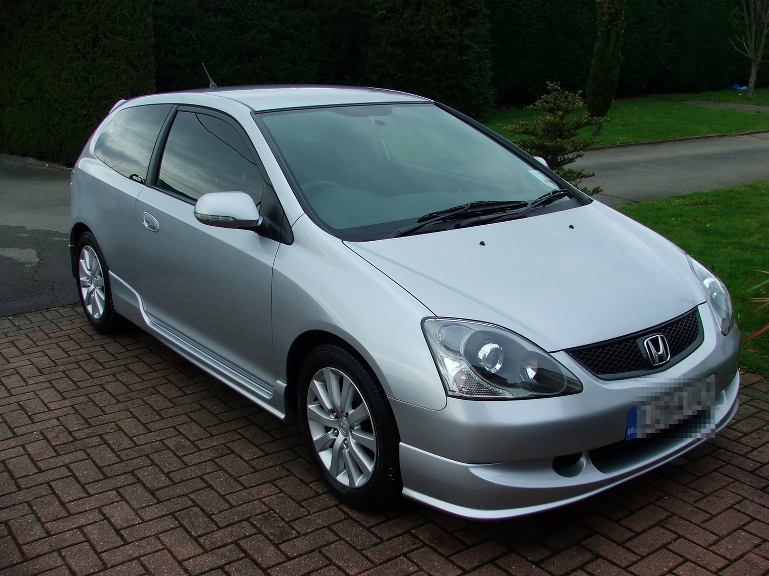

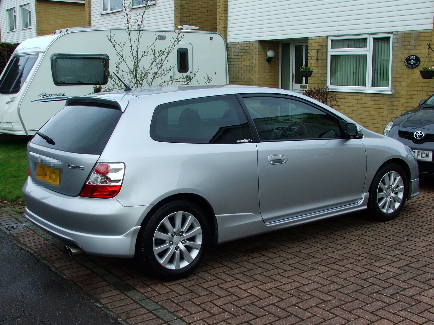

Hello all,
Finally got some pics of my EP2. Been out cleaning it this morning, so i'm now bloody freezing. lol.

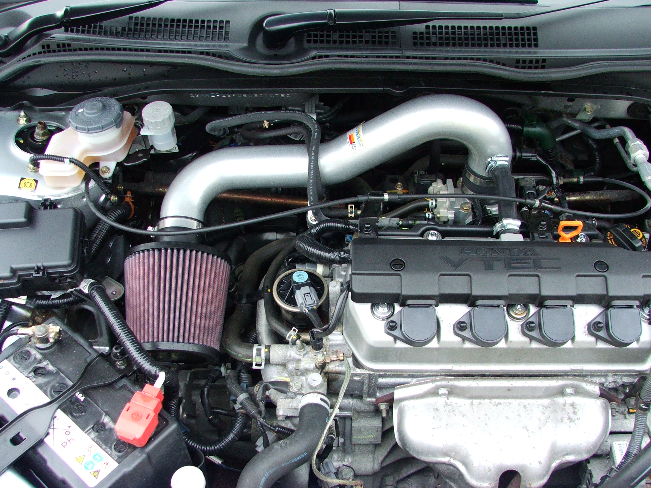

The only mods it has so far are the tints i had done last weekend and the K&N Typhoon induction kit.
The next thing on my list as to lower it (springs only as i cant really afford coilovers, and a new set of wheels).
I know its still pretty much standard, but i love it.. lol.. best car i have had...

IMO, the only mod those things need is Rims. What were honda thinking when they put those alloys on the car? They do nothing for me anyways. The Pentas that some people have look ace!

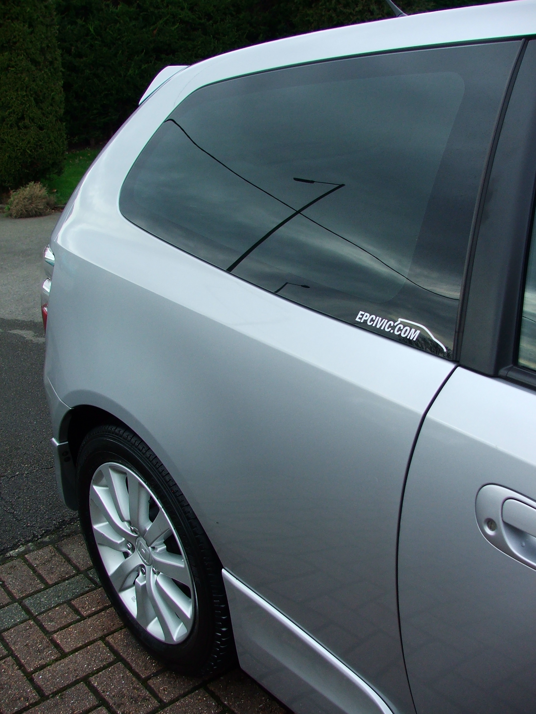

oh yer, nice stickers!

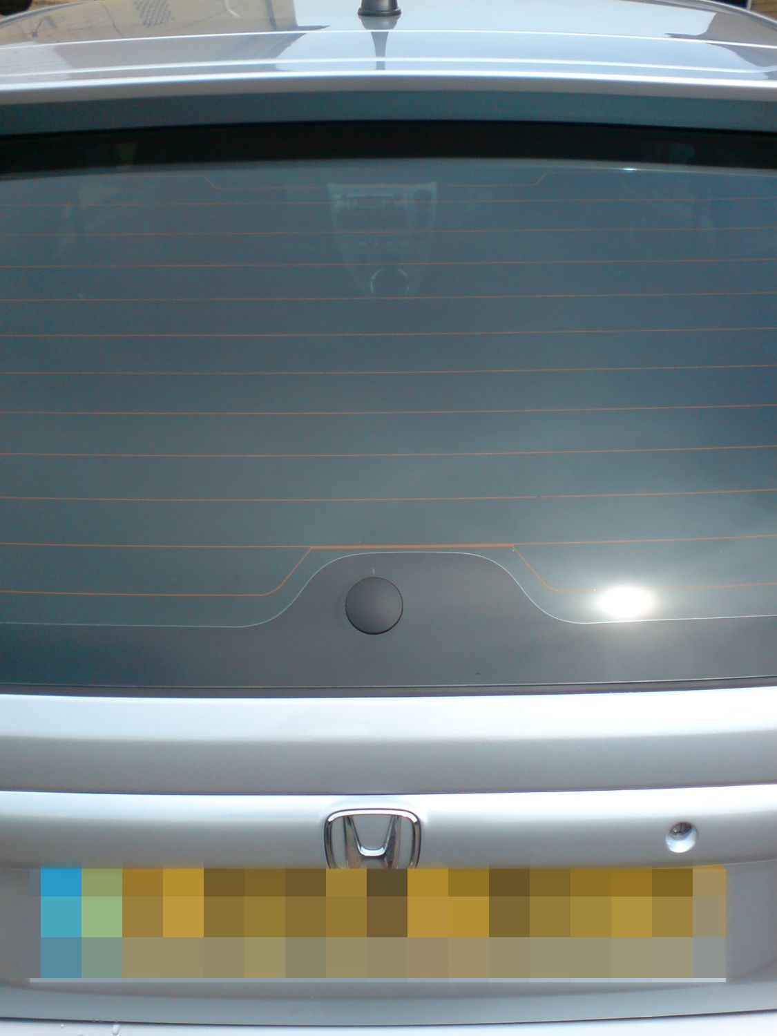

It was a realy easy mod to do, just put a bead of sealant on the back of the cap, let it dry for half an hour, then screwed the cap in place. Removed the washer tube on the inside of the rear hatch (not forgetting to plug the end), taped the wiper motor plug out of the way, removed the fuse (just in case) the unplugged the rear washer pump plug from under the wheel arch.
In all it took about 1 hour 15 mins...
Not bad at all!
Here are a couple of pictures after i fitted it.

have to admit it looks kinda odd a think it looks better with it on
With a spoiler on i think it woiuld look superb

looks ok not too keen on these cars being de-wipered on the back mind.
someone on ctro forum changed the rear arm for a slim aero blade wiper. looks better. bought it from VW i think.
